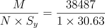

Fb' = Fb(CD)(CM)(Ct)(CL)(CF)(Cfu)(Ci)(Cr)
The depth of the beam does not exceed its breadth. Laterial stability is not a consideration:
Fby' = (1400)(1.15)(1)(1)(1)(1)(1.1)(0.8)(1.15) = 1629.3 psi
fb = = 1256.7 psi
 fb = 1256.7 psi < Fby' = 1629.3 psi  (CSI = 0.77)   ➜  OK

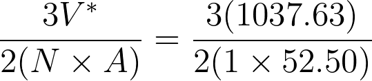

Fvy' = (150)(1.15)(1)(1)(0.8) = 138.00 psi
fv* = = 29.65 psi
 fv* = 29.65 psi < Fvy' = 138.00 psi  (CSI = 0.21)   ➜  OK

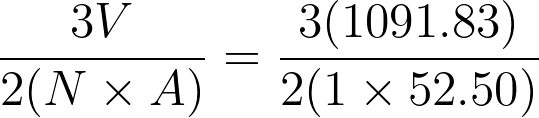

fv = = 31.20 psi
 fv = 31.20 psi < Fvy' = 138.00 psi  (CSI = 0.23)   ➜  OK

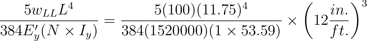

ΔLL = = 0.53 in.
(L/d)LL = 141.00 / 0.53 = 268
 ΔLL = 0.53 in = L/268 > L/360   ➜  NG

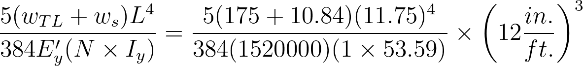

ΔTL = = 0.98 in.
(L/d)TL = 141.00 / 0.98 = 144
 ΔTL = 0.98 in = L/144 > L/240   ➜  NG

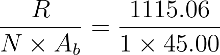

Fc⊥y' = (405)(1)(1)(1) = 405.00 psi
Ab = d x lb = 15 x 3 = 45.00 in2
fc⊥ = = 24.8 psi
 fc⊥ = 24.8 psi < Fc⊥y' = 405.00 psi  (CSI = 0.06)   ➜  OK
