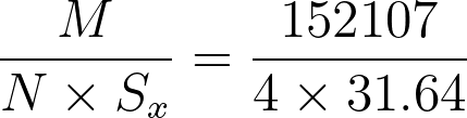

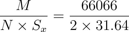

Fbx' = (1500)(1.15)(1)(1)(1)(1)(0.8)(1) = 1380.0 psi
fb = = 1201.8 psi
 fb = 1201.8 psi < Fbx' = 1380.0 psi  (CSI = 0.87)   ➜  OK

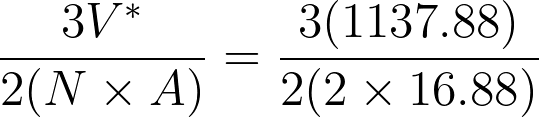

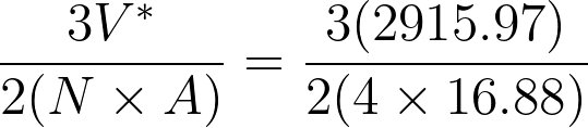

Fvx' = (180)(1.15)(1)(1)(0.8) = 165.60 psi
fv* = = 64.80 psi
 fv* = 64.80 psi < Fvx' = 165.60 psi  (CSI = 0.39)   ➜  OK

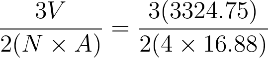

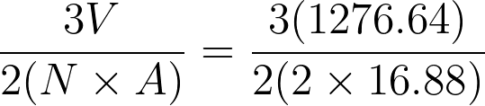

fv = = 73.88 psi
 fv = 73.88 psi < Fvx' = 165.60 psi  (CSI = 0.45)   ➜  OK

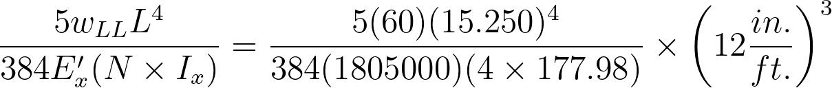

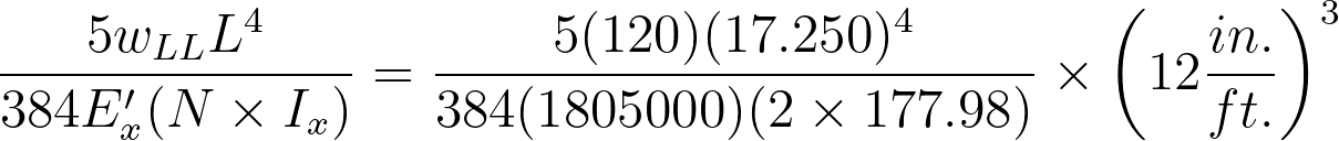

ΔLL = = 0.06 in.
(L/d)LL = 183.00 / 0.06 = 3221
 ΔLL = 0.06 in = L/3221 < L/360   ➜  OK

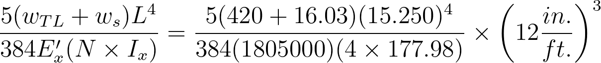

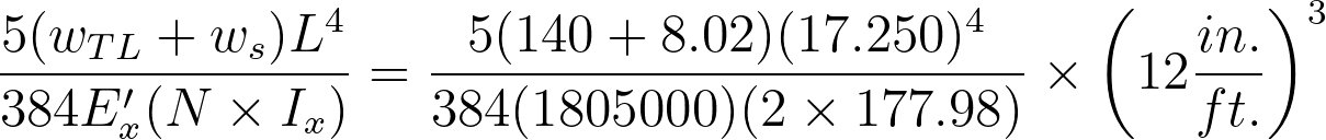

ΔTL = = 0.41 in.
(L/d)TL = 183.00 / 0.41 = 443
 ΔTL = 0.41 in = L/443 < L/240   ➜  OK

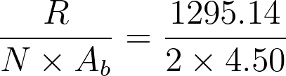

Ab = b x lb = 1.5 x 3 = 4.50 in2
fc⊥ = = 187.7 psi
 fc⊥ = 187.7 psi < Fc⊥x' = 625.00 psi  (CSI = 0.30)   ➜  OK
