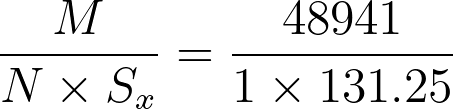

Fbx' = (850)(1.15)(1)(1)(1)(1)(0.8)(1.15) = 899.3 psi
fb = = 372.9 psi
 fb = 372.9 psi < Fbx' = 899.3 psi  (CSI = 0.41)   ➜  OK

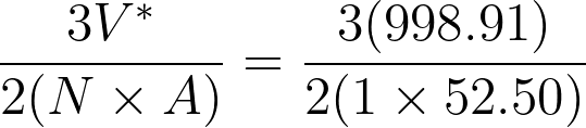

Fvx' = (150)(1.15)(1)(1)(0.8) = 138.00 psi
fv* = = 28.54 psi
 fv* = 28.54 psi < Fvx' = 138.00 psi  (CSI = 0.21)   ➜  OK

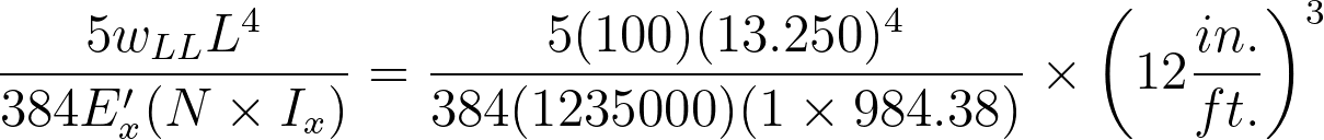

ΔLL = = 0.06 in.
(L/d)LL = 159.00 / 0.06 = 2787
 ΔLL = 0.06 in = L/2787 < L/360   ➜  OK

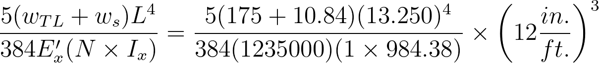

ΔTL = = 0.11 in.
(L/d)TL = 159.00 / 0.11 = 1500
 ΔTL = 0.11 in = L/1500 < L/240   ➜  OK

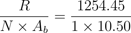

Fc⊥x' = (405)(1)(1)(1) = 405.00 psi
fc⊥ = = 119.5 psi
 fc⊥ = 119.5 psi < Fc⊥x' = 405.00 psi  (CSI = 0.29)   ➜  OK
