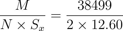

Fbx' = Fbx(CD)(CM)(Ct)(CV)   or   Fbx' = Fbx(CD)(CM)(Ct)(CL)
CV = = 1.0
Neither volume effect nor lateral stability govern:
CV = 1.0
Fbx' = (2400)(2.00)(1)(1)(1.0) = 4800.0 psi
fb = = 1527.2 psi
 fb = 1527.2 psi < Fbx' = 4800.0 psi  (CSI = 0.32)   ➜  OK

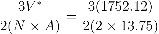

Fv' = Fv(CD)(CM)(Ct)
Fvx' = (300)(2.00)(1)(1) = 600.00 psi
fv* = = 95.57 psi
 fv* = 95.57 psi < Fvx' = 600.00 psi  (CSI = 0.16)   ➜  OK

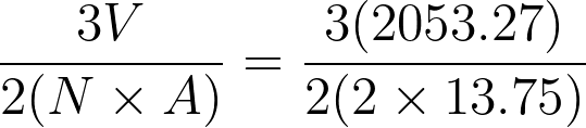

fv = = 112.00 psi
 fv = 112.00 psi < Fvx' = 600.00 psi  (CSI = 0.19)   ➜  OK

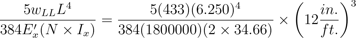

ΔLL = = 0.12 in.
(L/d)LL = 75.00 / 0.12 = 630
 ΔLL = 0.12 in = L/630 < L/360   ➜  OK

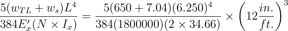

ΔTL = = 0.18 in.
(L/d)TL = 75.00 / 0.18 = 415
 ΔTL = 0.18 in = L/415 < L/240   ➜  OK

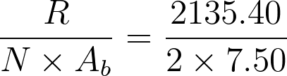

Fc⊥' = Fc⊥(CM)(Ct)
Fc⊥x' = (740)(1)(1) = 740.00 psi
Ab = b x lb = 2.5 x 3 = 7.50 in2
fc⊥ = = 142.4 psi
 fc⊥ = 142.4 psi < Fc⊥x' = 740.00 psi  (CSI = 0.19)   ➜  OK
