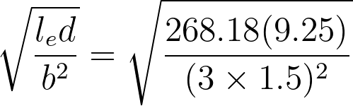

Beam is unbraced along its compression edge, lateral stability is considered below:
Slenderness Ratio for bending member RB:
lu = Unbraced Length = 12.292 ft.
lu/d = = 15.95
le = 1.63lu + 3d = 1.63(147.5) + 3(9.25) = 268.18 in. = 22.35 ft.  (NDS Table 3.3.3)
Rb = = 11.07
 Rb = 11.07 < 50   ➜  OK

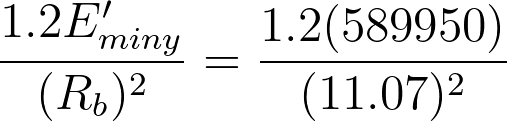

Euler-based ASD critical buckling value for bending members:
Eminy' = Eminy(CM)(Ct)(Ci) = 690000(0.9)(1)(0.95) = 589950 psi
FbE = = 5778.98 psi

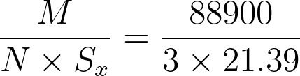

Fbx* = Fbx(CD)(CM)(Ct)(CF)(Ci)(Cr) = (1500)(1.15)(0.85)(1)(1.1)(0.8)(1.15) = 1483.84 psi
Beam stability factor:
CL =   = 0.983
Fbx' = (1500)(1.15)(0.85)(1)(0.983)(1.1)(0.8)(1.15) = 1459.2 psi
fb = = 1385.3 psi
 fb = 1385.3 psi < Fbx' = 1459.2 psi  (CSI = 0.95)   ➜  OK

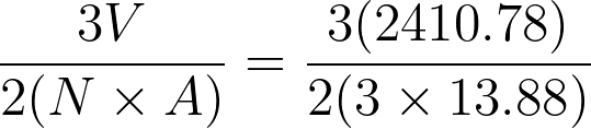

Fvx' = (180)(1.15)(0.97)(1)(0.8) = 160.63 psi
Shear Reduction: Uniformly distributed loads within a distance, d, from supports equal to the depth of the bending member shall be pemitted to be ignored. Concentrated loads within a distance equal to the depth of the bending member from supports shall be permitted to be multiplied by x/d where x is the distance from the beam support face to the load. See NDS 2015, Figure 3C.
fv* = = 75.98 psi
 fv* = 75.98 psi < Fvx' = 160.63 psi  (CSI = 0.47)   ➜  OK
fv = = 86.88 psi
 fv = 86.88 psi < Fvx' = 160.63 psi  (CSI = 0.54)   ➜  OK

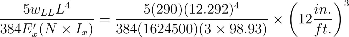

LL Allowable: L/240
TL Allowable: L/180
Ex' = Ex(CM)(Ct)(Ci) = 1900000(0.9)(1)(0.95) = 1624500 psi
ΔLL = = 0.31 in.
(L/d)LL = 147.50 / 0.31 = 477
 ΔLL = 0.31 in = L/477 < L/240   ➜  OK

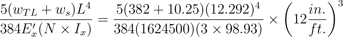

ΔTL = = 0.42 in.
(L/d)TL = 147.50 / 0.42 = 353
 ΔTL = 0.42 in = L/353 < L/180   ➜  OK

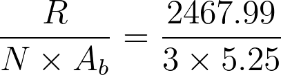

Fc⊥x' = (625)(0.67)(1)(1) = 418.75 psi
Ab = b x lb = 1.5 x 3.5 = 5.25 in2
fc⊥ = = 156.7 psi
 fc⊥ = 156.7 psi < Fc⊥x' = 418.75 psi  (CSI = 0.37)   ➜  OK
