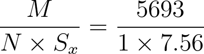

Fbx' = (1000)(2.00)(1)(1)(1)(1)(1)(1) = 2000.0 psi
fb = = 752.8 psi
 fb = 752.8 psi < Fbx' = 2000.0 psi  (CSI = 0.38)   ➜  OK

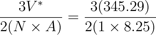

Fvx' = (175)(2.00)(1)(1)(1) = 350.00 psi
fv* = = 62.78 psi
 fv* = 62.78 psi < Fvx' = 350.00 psi  (CSI = 0.18)   ➜  OK

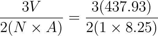

fv = = 79.62 psi
 fv = 79.62 psi < Fvx' = 350.00 psi  (CSI = 0.23)   ➜  OK

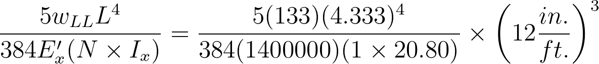

ΔLL = = 0.04 in.
(L/d)LL = 52.00 / 0.04 = 1435
 ΔLL = 0.04 in = L/1435 < L/360   ➜  OK

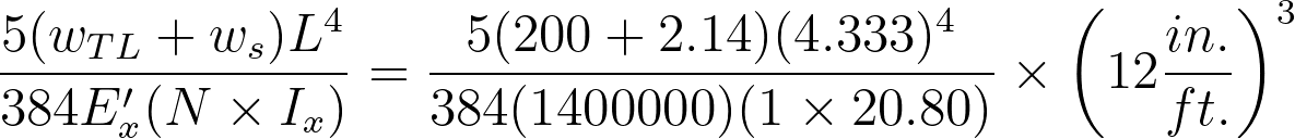

ΔTL = = 0.06 in.
(L/d)TL = 52.00 / 0.06 = 944
 ΔTL = 0.06 in = L/944 < L/240   ➜  OK

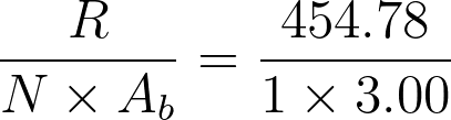

Fc⊥x' = (565)(1)(1)(1) = 565.00 psi
Ab = b x lb = 1.5 x 2 = 3.00 in2
fc⊥ = = 151.6 psi
 fc⊥ = 151.6 psi < Fc⊥x' = 565.00 psi  (CSI = 0.27)   ➜  OK
