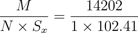

Fbx' = (850)(1.15)(1)(1)(1)(1)(0.8)(1.15) = 899.3 psi
fb = = 138.7 psi
 fb = 138.7 psi < Fbx' = 899.3 psi  (CSI = 0.15)   ➜  OK

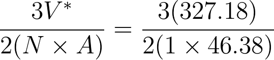

Fvx' = (150)(1.15)(1)(1)(0.8) = 138.00 psi
fv* = = 10.58 psi
 fv* = 10.58 psi < Fvx' = 138.00 psi  (CSI = 0.08)   ➜  OK

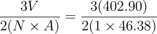

fv = = 13.03 psi
 fv = 13.03 psi < Fvx' = 138.00 psi  (CSI = 0.09)   ➜  OK

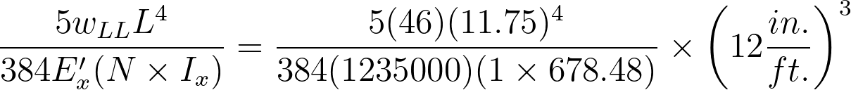

ΔLL = = 0.02 in.
(L/d)LL = 141.00 / 0.02 = 5989
 ΔLL = 0.02 in = L/5989 < L/360   ➜  OK

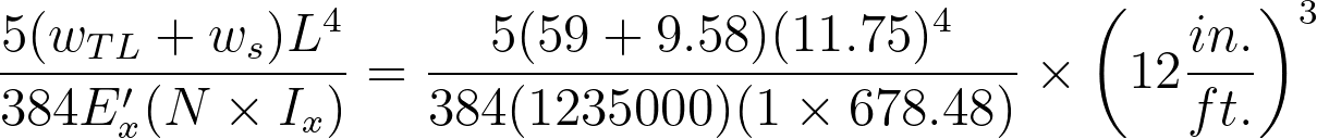

ΔTL = = 0.04 in.
(L/d)TL = 141.00 / 0.04 = 4017
 ΔTL = 0.04 in = L/4017 < L/240   ➜  OK

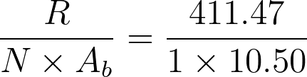

Fc⊥x' = (405)(1)(1)(1) = 405.00 psi
fc⊥ = = 39.2 psi
 fc⊥ = 39.2 psi < Fc⊥x' = 405.00 psi  (CSI = 0.10)   ➜  OK
