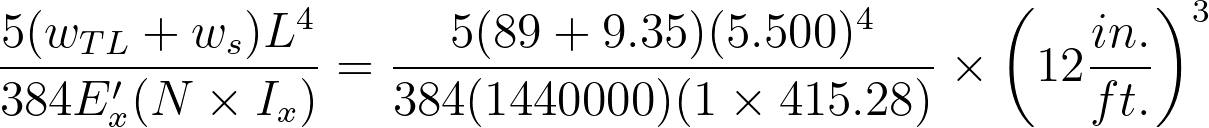

LL Allowable: L/180
TL Allowable: L/120
Ex' = Ex(CM)(Ct)(Ci) = 1600000(1)(0.9)(1) = 1440000 psi
ΔLL = = 0.00 in.
(L/d)LL = 66.00 / 0.00 = 28191
 ΔLL = 0.00 in = L/28191 < L/180   ➜  OK
ΔTL = = 0.00 in.
(L/d)TL = 66.00 / 0.00 = 19491
 ΔTL = 0.00 in = L/19491 < L/120   ➜  OK

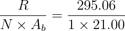

Fc⊥x' = (625)(1)(0.8)(1) = 500.00 psi
Ab = b x lb = 3.5 x 6 = 21.00 in2
fc⊥ = = 14.1 psi
 fc⊥ = 14.1 psi < Fc⊥x' = 500.00 psi  (CSI = 0.03)   ➜  OK
