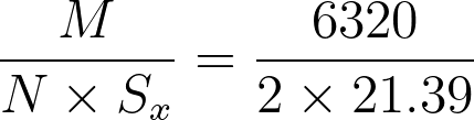

Fbx' = (1050)(1.00)(1)(1)(1)(1)(1)(1) = 1050.0 psi
fb = = 147.7 psi
 fb = 147.7 psi < Fbx' = 1050.0 psi  (CSI = 0.14)   ➜  OK

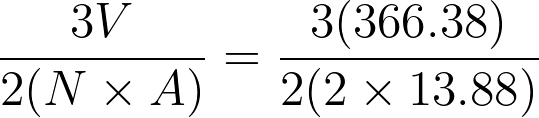

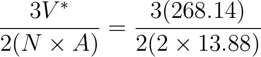

Fvx' = (175)(1.00)(0.97)(1)(1) = 169.75 psi
fv* = = 14.49 psi
 fv* = 14.49 psi < Fvx' = 169.75 psi  (CSI = 0.09)   ➜  OK
fv = = 19.80 psi
 fv = 19.80 psi < Fvx' = 169.75 psi  (CSI = 0.12)   ➜  OK

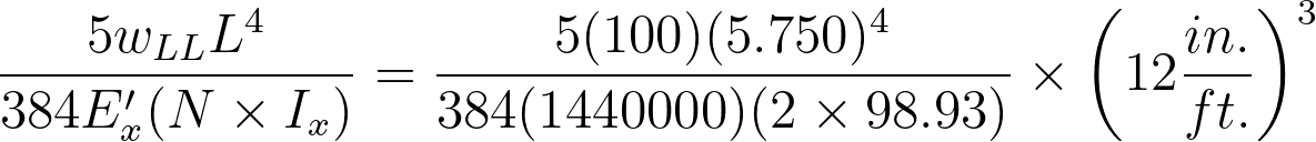

ΔLL = = 0.01 in.
(L/d)LL = 69.00 / 0.01 = 7993
 ΔLL = 0.01 in = L/7993 < L/360   ➜  OK

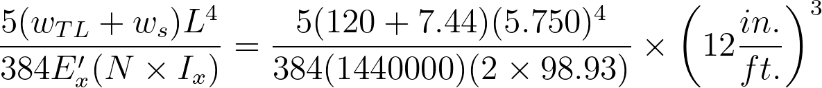

ΔTL = = 0.01 in.
(L/d)TL = 69.00 / 0.01 = 6272
 ΔTL = 0.01 in = L/6272 < L/240   ➜  OK

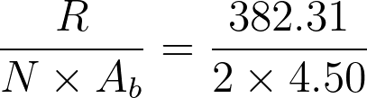

Fc⊥x' = (565)(0.67)(1)(1) = 378.55 psi
Ab = b x lb = 1.5 x 3 = 4.50 in2
fc⊥ = = 42.5 psi
 fc⊥ = 42.5 psi < Fc⊥x' = 378.55 psi  (CSI = 0.11)   ➜  OK
