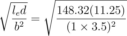

Beam is unbraced along its compression edge, lateral stability is considered below:
Slenderness Ratio for bending member RB:
lu = Unbraced Length = 6 ft.
lu/d = = 6.40
le = 2.06lu = 2.06(72.0) = 148.32 in. = 12.36 ft.  (NDS Table 3.3.3)
Rb = = 11.67
 Rb = 11.67 < 50   ➜  OK

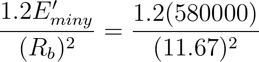

Euler-based ASD critical buckling value for bending members:
Eminy' = Eminy(CM)(Ct)(Ci) = 580000(1)(1)(1) = 580000 psi
FbE = = 5109.67 psi

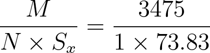

Fbx' = (900)(1.00)(1)(1)(0.988)(1.1)(1)(1) = 978.4 psi
fb = = 47.1 psi
 fb = 47.1 psi < Fbx' = 978.4 psi  (CSI = 0.05)   ➜  OK

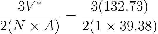

Fvx' = (180)(1.00)(1)(1)(1) = 180.00 psi

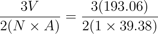

Shear Reduction: Uniformly distributed loads within a distance, d, from supports equal to the depth of the bending member shall be pemitted to be ignored. Concentrated loads within a distance equal to the depth of the bending member from supports shall be permitted to be multiplied by x/d where x is the distance from the beam support face to the load. See NDS 2015, Figure 3C.
fv* = = 5.06 psi
 fv* = 5.06 psi < Fvx' = 180.00 psi  (CSI = 0.03)   ➜  OK
fv = = 7.35 psi
 fv = 7.35 psi < Fvx' = 180.00 psi  (CSI = 0.04)   ➜  OK

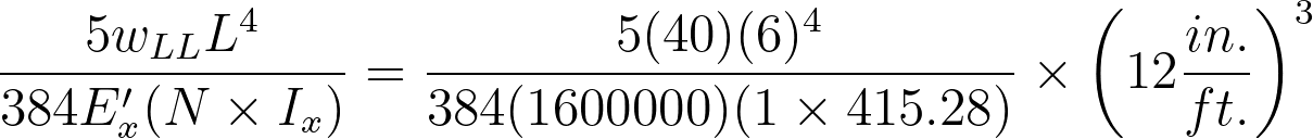

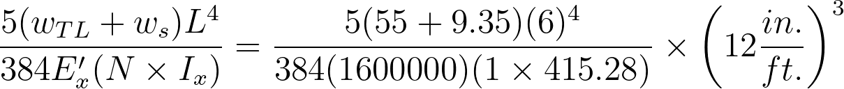

ΔLL = = 0.00 in.
(L/d)LL = 72.00 / 0.00 = 41016
 ΔLL = 0.00 in = L/41016 < L/360   ➜  OK
ΔTL = = 0.00 in.
(L/d)TL = 72.00 / 0.00 = 25494
 ΔTL = 0.00 in = L/25494 < L/240   ➜  OK

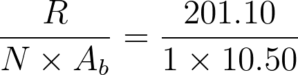

fc⊥ = = 19.2 psi
 fc⊥ = 19.2 psi < Fc⊥x' = 625.00 psi  (CSI = 0.03)   ➜  OK
