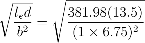

le = 1.63lu + 3d = 1.63(209.5) + 3(13.5) = 381.98 in. = 31.83 ft.  (NDS Table 3.3.3)
Rb = = 10.64
 Rb = 10.64 < 50   ➜  OK

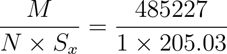

fb = = 2366.6 psi
 fb = 2366.6 psi < Fbx' = 2702.1 psi  (CSI = 0.88)   ➜  OK

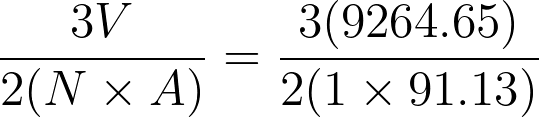

fv = = 152.50 psi
 fv = 152.50 psi < Fvx' = 304.75 psi  (CSI = 0.50)   ➜  OK

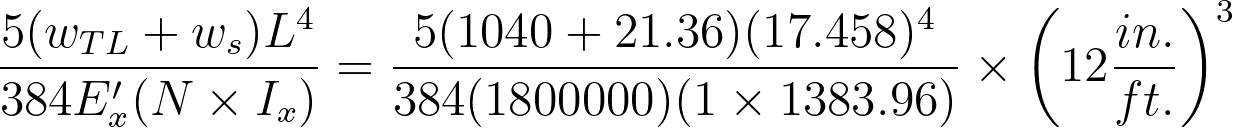

ΔTL = = 0.89 in.
(L/d)TL = 209.50 / 0.89 = 235
 ΔTL = 0.89 in = L/235 < L/180   ➜  OK

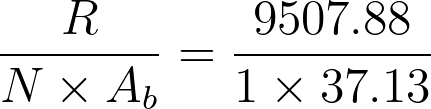

Ab = b x lb = 6.75 x 5.5 = 37.13 in2
fc⊥ = = 256.1 psi
 fc⊥ = 256.1 psi < Fc⊥x' = 650.00 psi  (CSI = 0.39)   ➜  OK
