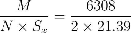

Fbx' = (1050)(1.00)(1)(1)(1)(1)(1)(1) = 1050.0 psi
fb = = 147.4 psi
 fb = 147.4 psi < Fbx' = 1050.0 psi  (CSI = 0.14)   ➜  OK

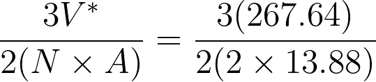

Fvx' = (175)(1.00)(1)(1)(1) = 175.00 psi
fv* = = 14.47 psi
 fv* = 14.47 psi < Fvx' = 175.00 psi  (CSI = 0.08)   ➜  OK

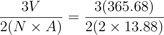

fv = = 19.77 psi
 fv = 19.77 psi < Fvx' = 175.00 psi  (CSI = 0.11)   ➜  OK

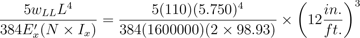

ΔLL = = 0.01 in.
(L/d)LL = 69.00 / 0.01 = 8074
 ΔLL = 0.01 in = L/8074 < L/360   ➜  OK

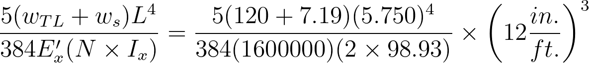

ΔTL = = 0.01 in.
(L/d)TL = 69.00 / 0.01 = 6983
 ΔTL = 0.01 in = L/6983 < L/240   ➜  OK

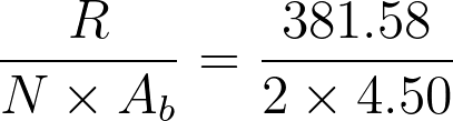

Fc⊥x' = (565)(1)(1)(1) = 565.00 psi
Ab = b x lb = 1.5 x 3 = 4.50 in2
fc⊥ = = 42.4 psi
 fc⊥ = 42.4 psi < Fc⊥x' = 565.00 psi  (CSI = 0.08)   ➜  OK
