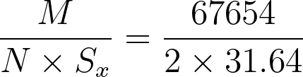

fb = = 1069.1 psi
 fb = 1069.1 psi > Fbx' = 870.8 psi  (CSI = 1.23)   ➜  NG

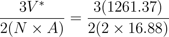

Shear Reduction: Uniformly distributed loads within a distance, d, from supports equal to the depth of the bending member shall be pemitted to be ignored. Concentrated loads within a distance equal to the depth of the bending member from supports shall be permitted to be multiplied by x/d where x is the distance from the beam support face to the load. See NDS 2015, Figure 3C.
fv* = = 56.06 psi
 fv* = 56.06 psi < Fvx' = 135.00 psi  (CSI = 0.42)   ➜  OK

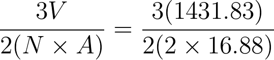

fv = = 63.64 psi
 fv = 63.64 psi < Fvx' = 135.00 psi  (CSI = 0.47)   ➜  OK

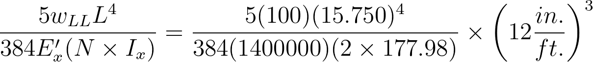

ΔLL = = 0.28 in.
(L/d)LL = 189.00 / 0.28 = 680
 ΔLL = 0.28 in = L/680 < L/360   ➜  OK

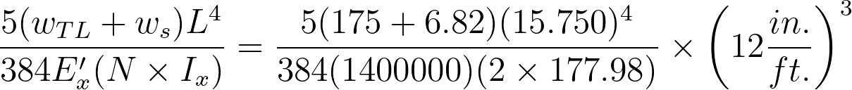

(L/d)TL = 189.00 / 0.51 = 374
 ΔTL = 0.51 in = L/374 < L/240   ➜  OK

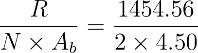

Fc⊥x' = (425)(1)(1)(1) = 425.00 psi
Ab = b x lb = 1.5 x 3 = 4.50 in2
fc⊥ = = 161.6 psi
 fc⊥ = 161.6 psi < Fc⊥x' = 425.00 psi  (CSI = 0.38)   ➜  OK
