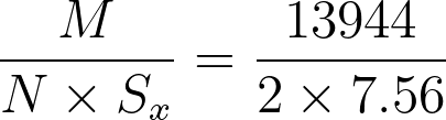

Fbx' = (875)(1.15)(1)(1)(1)(1.3)(1)(1) = 1308.1 psi
fb = = 921.9 psi
 fb = 921.9 psi < Fbx' = 1308.1 psi  (CSI = 0.70)   ➜  OK

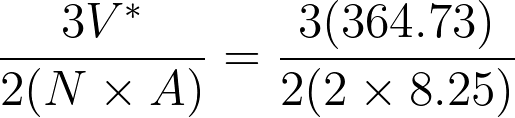

Fvx' = (135)(1.15)(1)(1)(1) = 155.25 psi
fv* = = 33.16 psi
 fv* = 33.16 psi < Fvx' = 155.25 psi  (CSI = 0.21)   ➜  OK

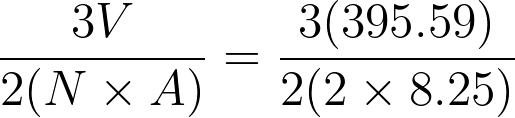

fv = = 35.96 psi
 fv = 35.96 psi < Fvx' = 155.25 psi  (CSI = 0.23)   ➜  OK

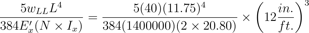

LL Allowable: L/180

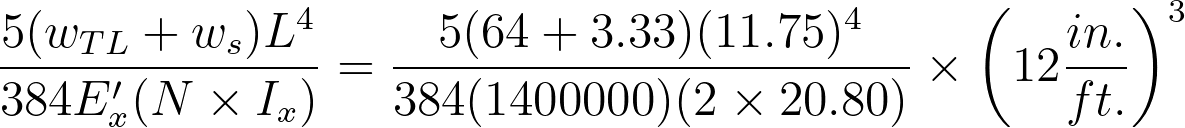

TL Allowable: L/120
Ex' = Ex(CM)(Ct)(Ci) = 1400000(1)(1)(1) = 1400000 psi
Beam Design 2026A74
2/24/2026 5
ΔLL = = 0.29 in.
(L/d)LL = 141.00 / 0.29 = 479
 ΔLL = 0.29 in = L/479 < L/180   ➜  OK
ΔTL = = 0.50 in.
(L/d)TL = 141.00 / 0.50 = 284
 ΔTL = 0.50 in = L/284 < L/120   ➜  OK

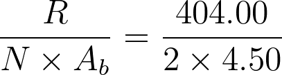

Fc⊥x' = (425)(1)(1)(1) = 425.00 psi
Ab = b x lb = 1.5 x 3 = 4.50 in2
fc⊥ = = 44.9 psi
 fc⊥ = 44.9 psi < Fc⊥x' = 425.00 psi  (CSI = 0.11)   ➜  OK
