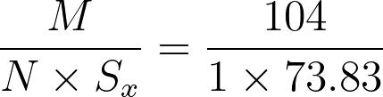

Fbx' = (900)(1.15)(1)(1)(1)(1.1)(1)(1) = 1138.5 psi
fb = = 1.4 psi
 fb = 1.4 psi < Fbx' = 1138.5 psi  (CSI = 0.00)   ➜  OK

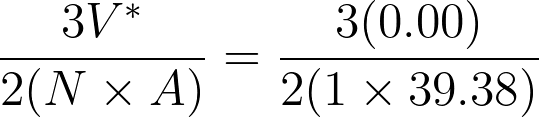

Fvx' = (180)(1.15)(1)(1)(1) = 207.00 psi
fv* = = 0.00 psi
 fv* = 0.00 psi < Fvx' = 207.00 psi  (CSI = 0.00)   ➜  OK

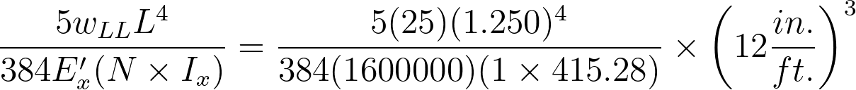

ΔLL = = 0.00 in.
(L/d)LL = 15.00 / 0.00 = 7257600
 ΔLL = 0.00 in = L/7257600 < L/360   ➜  OK

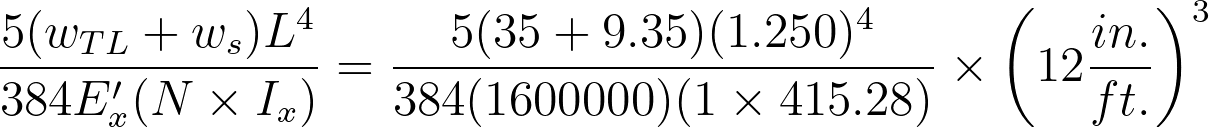

ΔTL = = 0.00 in.
(L/d)TL = 15.00 / 0.00 = 4090859
 ΔTL = 0.00 in = L/4090859 < L/240   ➜  OK

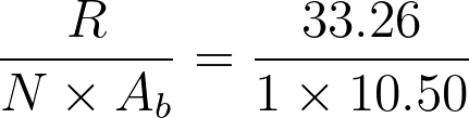

fc⊥ = = 3.2 psi
 fc⊥ = 3.2 psi < Fc⊥x' = 625.00 psi  (CSI = 0.01)   ➜  OK
