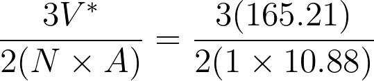

fv* = = 22.79 psi
 fv* = 22.79 psi < Fvx' = 207.00 psi  (CSI = 0.11)   ➜  OK

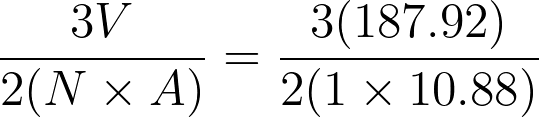

fv = = 25.92 psi
 fv = 25.92 psi < Fvx' = 207.00 psi  (CSI = 0.13)   ➜  OK

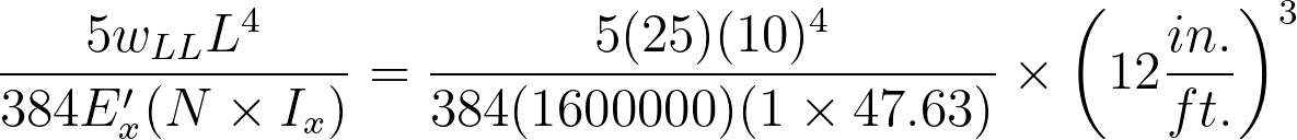

ΔLL = = 0.07 in.
(L/d)LL = 120.00 / 0.07 = 1626
 ΔLL = 0.07 in = L/1626 < L/360   ➜  OK

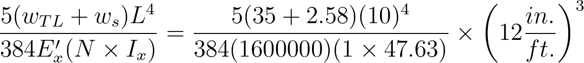

ΔTL = = 0.11 in.
(L/d)TL = 120.00 / 0.11 = 1082
 ΔTL = 0.11 in = L/1082 < L/240   ➜  OK
