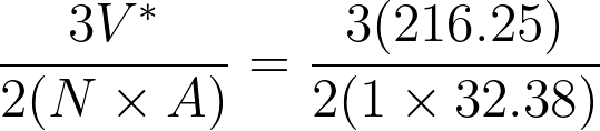

Fvx' = (180)(1.15)(1)(1)(1) = 207.00 psi
fv* = = 10.02 psi

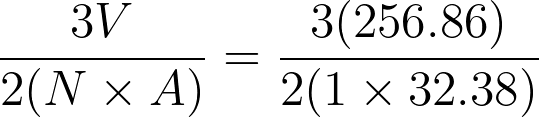

 fv* = 10.02 psi < Fvx' = 207.00 psi  (CSI = 0.05)   ➜  OK
fv = = 11.90 psi
 fv = 11.90 psi < Fvx' = 207.00 psi  (CSI = 0.06)   ➜  OK

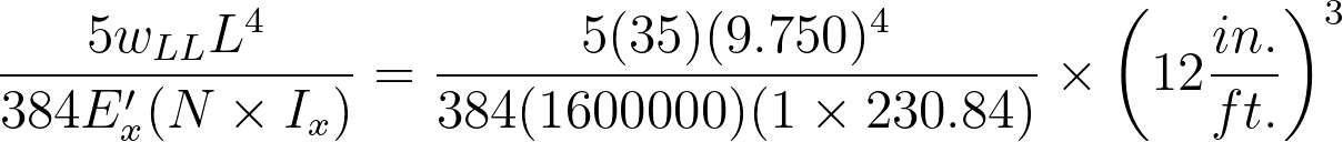

LL Allowable: L/180

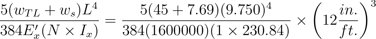

TL Allowable: L/120

ΔLL = = 0.02 in.
(L/d)LL = 117.00 / 0.02 = 6072
 ΔLL = 0.02 in = L/6072 < L/180   ➜  OK
ΔTL = = 0.03 in.
(L/d)TL = 117.00 / 0.03 = 4034
 ΔTL = 0.03 in = L/4034 < L/120   ➜  OK
