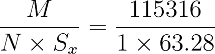

Fbx' = Fbx(CD)(CM)(Ct)(CV)   or   Fbx' = Fbx(CD)(CM)(Ct)(CL)
CV = = 1.0
Neither volume effect nor lateral stability govern:
CV = 1.0
Fbx' = (2400)(1.15)(1)(1)(1.0) = 2760.0 psi
fb = = 1822.3 psi
 fb = 1822.3 psi < Fbx' = 2760.0 psi  (CSI = 0.66)   ➜  OK

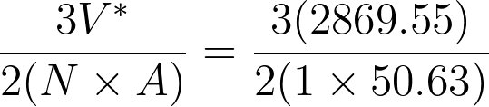

Fv' = Fv(CD)(CM)(Ct)
Fvx' = (265)(1.15)(1)(1) = 304.75 psi
fv* = = 85.02 psi
 fv* = 85.02 psi < Fvx' = 304.75 psi  (CSI = 0.28)   ➜  OK

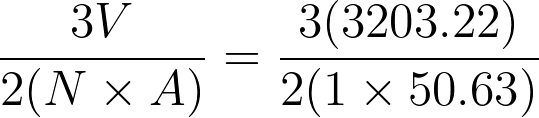

fv = = 94.91 psi
 fv = 94.91 psi < Fvx' = 304.75 psi  (CSI = 0.31)   ➜  OK

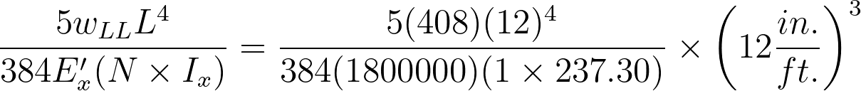

ΔLL = = 0.45 in.
(L/d)LL = 144.00 / 0.45 = 323
 ΔLL = 0.45 in = L/323 > L/360   ➜  NG

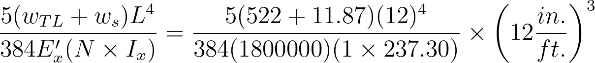

ΔTL = = 0.58 in.
(L/d)TL = 144.00 / 0.58 = 247
 ΔTL = 0.58 in = L/247 < L/240   ➜  OK

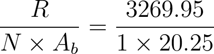

Fc⊥' = Fc⊥(CM)(Ct)
Fc⊥x' = (650)(1)(1) = 650.00 psi
Ab = b x lb = 6.75 x 3 = 20.25 in2
fc⊥ = = 161.5 psi
 fc⊥ = 161.5 psi < Fc⊥x' = 650.00 psi  (CSI = 0.25)   ➜  OK
