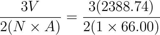

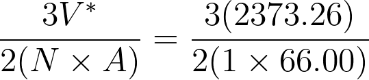

Fv' = Fv(CD)(CM)(Ct)
Fvx' = (265)(1.15)(1)(1) = 304.75 psi
fv* = = 53.94 psi
 fv* = 53.94 psi < Fvx' = 304.75 psi  (CSI = 0.18)   ➜  OK
fv = = 54.29 psi
 fv = 54.29 psi < Fvx' = 304.75 psi  (CSI = 0.18)   ➜  OK

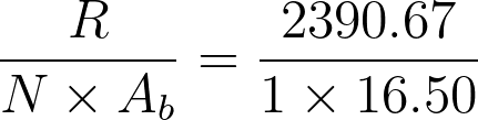

Fc⊥' = Fc⊥(CM)(Ct)
Fc⊥x' = (650)(1)(1) = 650.00 psi
Ab = b x lb = 5.5 x 3 = 16.50 in2
fc⊥ = = 144.9 psi
 fc⊥ = 144.9 psi < Fc⊥x' = 650.00 psi  (CSI = 0.22)   ➜  OK
