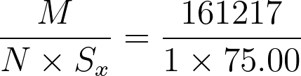

Fbx' = Fbx(CD)(CM)(Ct)(CV)   or   Fbx' = Fbx(CD)(CM)(Ct)(CL)
CV = = 1.0
Neither volume effect nor lateral stability govern:
CV = 1.0
Fbx' = (2400)(1.15)(1)(1)(1.0) = 2760.0 psi
fb = = 2149.6 psi
 fb = 2149.6 psi < Fbx' = 2760.0 psi  (CSI = 0.78)   ➜  OK

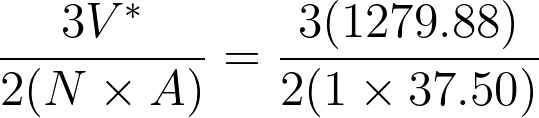

Fv' = Fv(CD)(CM)(Ct)
Fvx' = (265)(1.15)(1)(1) = 304.75 psi
fv* = = 51.20 psi
 fv* = 51.20 psi < Fvx' = 304.75 psi  (CSI = 0.17)   ➜  OK

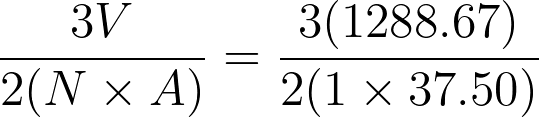

fv = = 51.55 psi
 fv = 51.55 psi < Fvx' = 304.75 psi  (CSI = 0.17)   ➜  OK

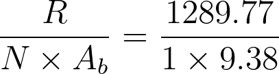

Fc⊥' = Fc⊥(CM)(Ct)
Fc⊥x' = (650)(1)(1) = 650.00 psi
Ab = b x lb = 3.125 x 3 = 9.38 in2
fc⊥ = = 137.6 psi
 fc⊥ = 137.6 psi < Fc⊥x' = 650.00 psi  (CSI = 0.21)   ➜  OK
