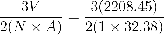

Fvx' = (180)(1.15)(1)(1)(1) = 207.00 psi
fv* = = 86.55 psi
 fv* = 86.55 psi < Fvx' = 207.00 psi  (CSI = 0.42)   ➜  OK

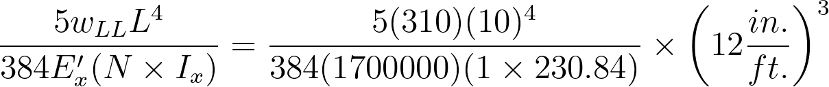

ΔLL = = 0.18 in.
(L/d)LL = 120.00 / 0.18 = 675
 ΔLL = 0.18 in = L/675 < L/360   ➜  OK

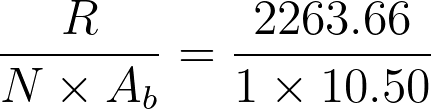

fc⊥ = = 215.6 psi
 fc⊥ = 215.6 psi < Fc⊥x' = 625.00 psi  (CSI = 0.34)   ➜  OK
