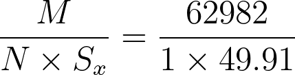

Fbx' = (1000)(1.15)(1)(1)(1)(1.2)(1)(1) = 1380.0 psi
fb = = 1261.9 psi
 fb = 1261.9 psi < Fbx' = 1380.0 psi  (CSI = 0.91)   ➜  OK

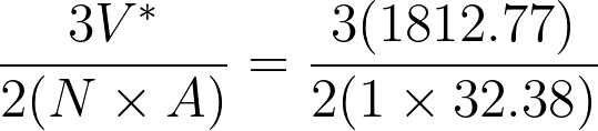

fv* = = 83.99 psi
 fv* = 83.99 psi < Fvx' = 207.00 psi  (CSI = 0.41)   ➜  OK

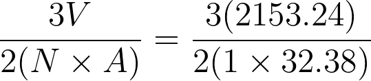

fv = = 99.76 psi
 fv = 99.76 psi < Fvx' = 207.00 psi  (CSI = 0.48)   ➜  OK

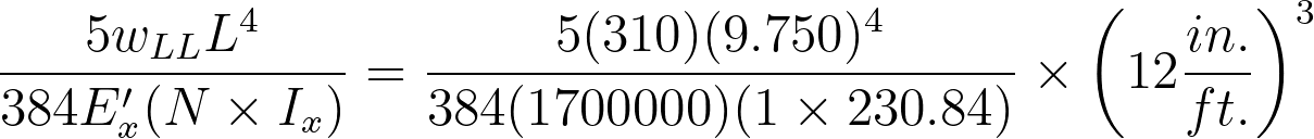

ΔLL = = 0.16 in.
(L/d)LL = 117.00 / 0.16 = 728
 ΔLL = 0.16 in = L/728 < L/360   ➜  OK

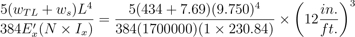

ΔTL = = 0.23 in.
(L/d)TL = 117.00 / 0.23 = 511
 ΔTL = 0.23 in = L/511 < L/240   ➜  OK
