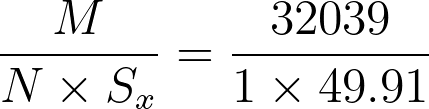

Fbx' = (900)(1.15)(1)(1)(1)(1.2)(1)(1) = 1242.0 psi
fb = = 641.9 psi
 fb = 641.9 psi < Fbx' = 1242.0 psi  (CSI = 0.52)   ➜  OK

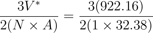

Fvx' = (180)(1.15)(1)(1)(1) = 207.00 psi
fv* = = 42.73 psi
 fv* = 42.73 psi < Fvx' = 207.00 psi  (CSI = 0.21)   ➜  OK
fv = = 50.75 psi
 fv = 50.75 psi < Fvx' = 207.00 psi  (CSI = 0.25)   ➜  OK

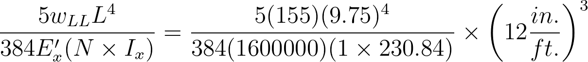

ΔLL = = 0.09 in.
(L/d)LL = 117.00 / 0.09 = 1371
 ΔLL = 0.09 in = L/1371 < L/360   ➜  OK

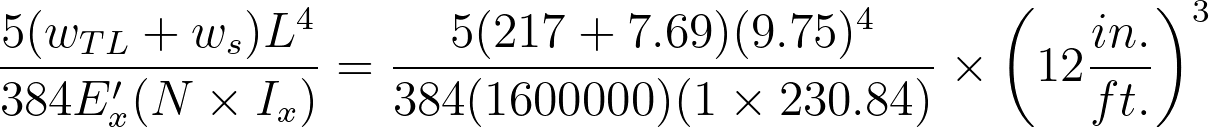

ΔTL = = 0.12 in.
(L/d)TL = 117.00 / 0.12 = 946
 ΔTL = 0.12 in = L/946 < L/240   ➜  OK

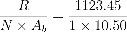

fc⊥ = = 107.0 psi
 fc⊥ = 107.0 psi < Fc⊥x' = 625.00 psi  (CSI = 0.17)   ➜  OK
