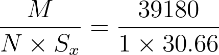

Fbx' = (900)(1.15)(1)(1)(1)(1.3)(1)(1) = 1345.5 psi
fb = = 1277.8 psi
 fb = 1277.8 psi < Fbx' = 1345.5 psi  (CSI = 0.95)   ➜  OK

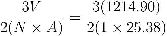

Fvx' = (180)(1.15)(1)(1)(1) = 207.00 psi
fv* = = 63.74 psi
 fv* = 63.74 psi < Fvx' = 207.00 psi  (CSI = 0.31)   ➜  OK
fv = = 71.82 psi
 fv = 71.82 psi < Fvx' = 207.00 psi  (CSI = 0.35)   ➜  OK

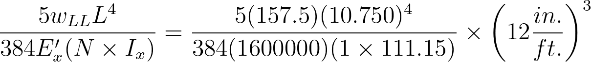

ΔLL = = 0.27 in.
(L/d)LL = 129.00 / 0.27 = 485
 ΔLL = 0.27 in = L/485 < L/360   ➜  OK
ΔTL = = 0.38 in.
(L/d)TL = 129.00 / 0.38 = 338
 ΔTL = 0.38 in = L/338 < L/240   ➜  OK

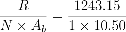

fc⊥ = = 118.4 psi
 fc⊥ = 118.4 psi < Fc⊥x' = 625.00 psi  (CSI = 0.19)   ➜  OK
