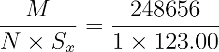

Fbx' = (2400)(1.15)(1)(1)(0.966) = 2667.0 psi
fb = = 2021.6 psi
 fb = 2021.6 psi < Fbx' = 2667.0 psi  (CSI = 0.76)   ➜  OK

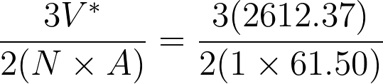

fv* = = 63.72 psi
 fv* = 63.72 psi < Fvx' = 304.75 psi  (CSI = 0.21)   ➜  OK

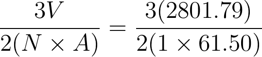

fv = = 68.34 psi
 fv = 68.34 psi < Fvx' = 304.75 psi  (CSI = 0.22)   ➜  OK

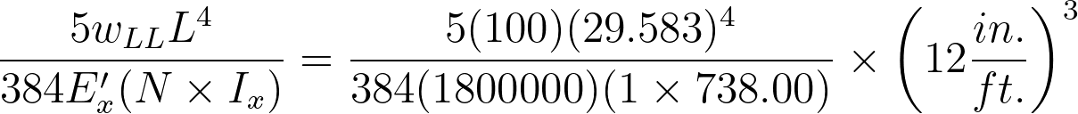

ΔLL = = 1.30 in.
(L/d)LL = 355.00 / 1.30 = 274
 ΔLL = 1.30 in = L/274 > L/360   ➜  NG

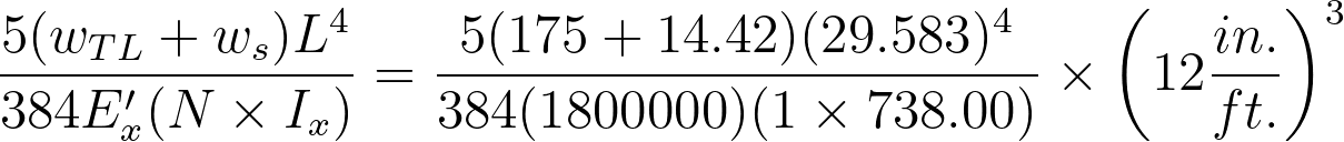

ΔTL = = 2.46 in.
(L/d)TL = 355.00 / 2.46 = 144
 ΔTL = 2.46 in = L/144 > L/240   ➜  NG

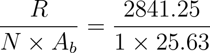

Ab = b x lb = 5.125 x 5 = 25.63 in2
fc⊥ = = 110.9 psi
 fc⊥ = 110.9 psi < Fc⊥x' = 650.00 psi  (CSI = 0.17)   ➜  OK
