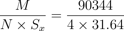

fb = = 713.8 psi
 fb = 713.8 psi < Fbx' = 944.8 psi  (CSI = 0.76)   ➜  OK

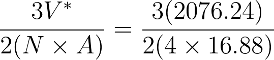

Shear Reduction: Uniformly distributed loads within a distance, d, from supports equal to the depth of the bending member shall be pemitted to be ignored. Concentrated loads within a distance equal to the depth of the bending member from supports shall be permitted to be multiplied by x/d where x is the distance from the beam support face to the load. See NDS 2015, Figure 3C.
fv* = = 46.14 psi
 fv* = 46.14 psi < Fvx' = 160.63 psi  (CSI = 0.29)   ➜  OK
