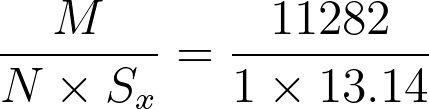

Fbx' = (900)(0.9)(1)(1)(1)(1.2)(1)(1) = 972.0 psi
fb = = 858.6 psi
 fb = 858.6 psi < Fbx' = 972.0 psi  (CSI = 0.88)   ➜  OK

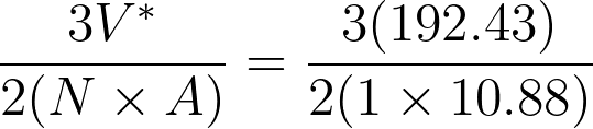

Fvx' = (180)(0.9)(1)(1)(1) = 162.00 psi
fv* = = 26.54 psi
 fv* = 26.54 psi < Fvx' = 162.00 psi  (CSI = 0.16)   ➜  OK

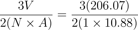

fv = = 28.42 psi
 fv = 28.42 psi < Fvx' = 162.00 psi  (CSI = 0.18)   ➜  OK

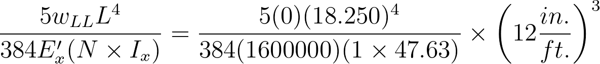

ΔLL = = 0.00 in.
(L/d)LL = 219.00 / 0.00 = ∞
 ΔLL = 0.00 in = L/∞ < L/360   ➜  OK

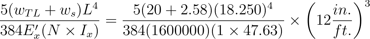

ΔTL = = 0.74 in.
(L/d)TL = 219.00 / 0.74 = 296
 ΔTL = 0.74 in = L/296 < L/240   ➜  OK

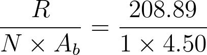

Ab = b x lb = 1.5 x 3 = 4.50 in2
fc⊥ = = 46.4 psi
 fc⊥ = 46.4 psi < Fc⊥x' = 625.00 psi  (CSI = 0.07)   ➜  OK
