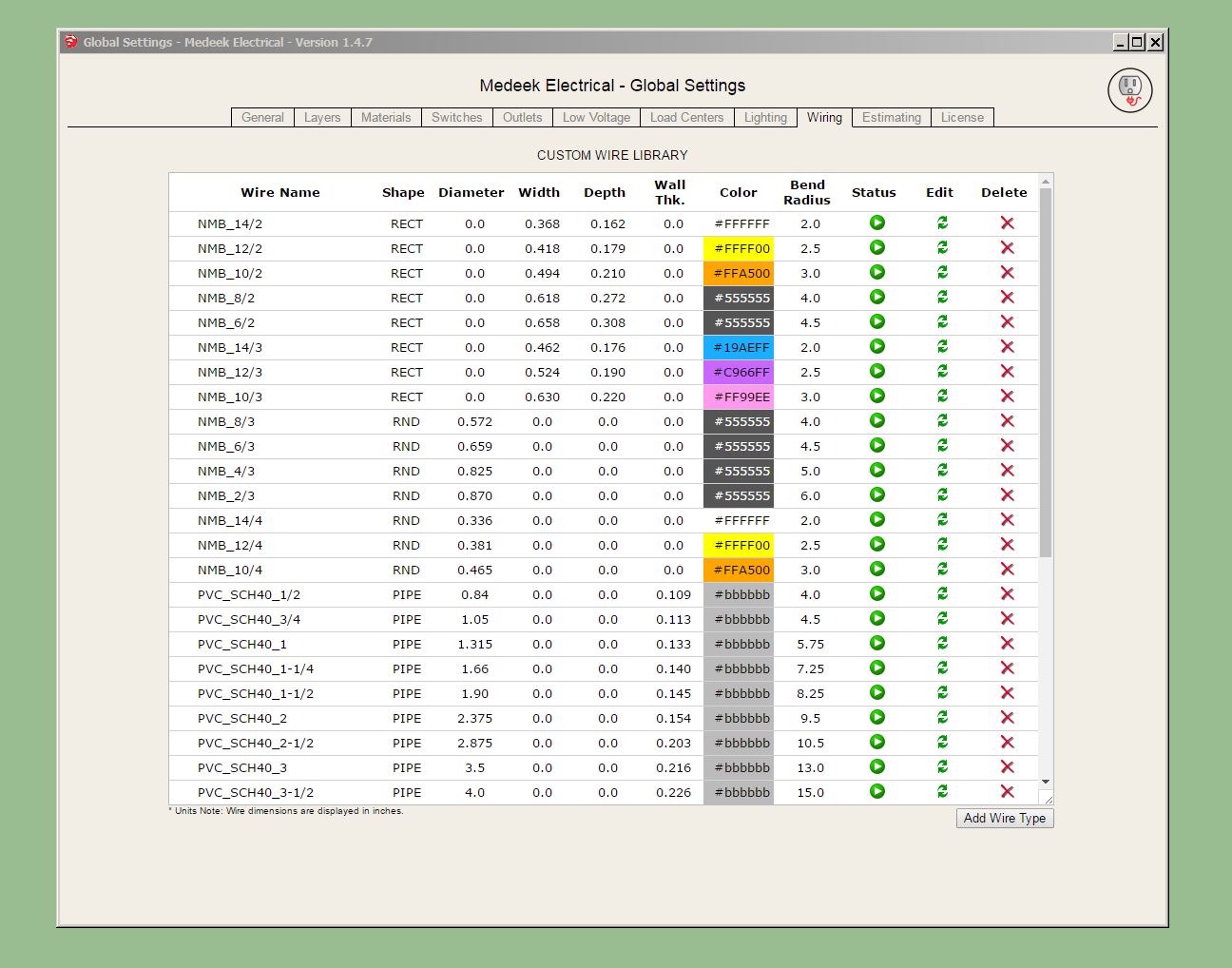

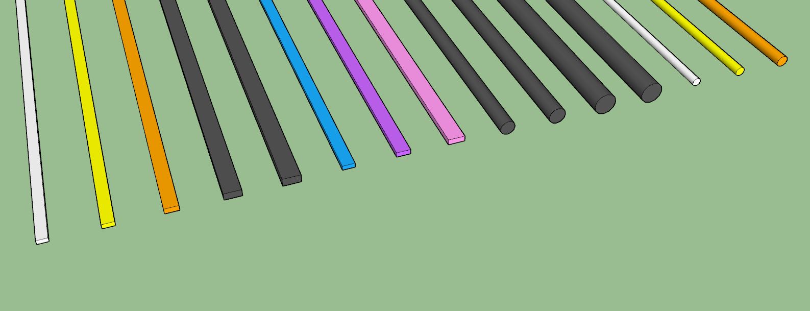

Version 1.5.2 - 06.02.2025
- Updated the wire library to include all the common NMB wire sizes.
This update per customer request.
Wire sizes per the Southwire (Romex) documentation:
http://design.medeek.com/resources/electricalplugin/references/2403_3-C_Romex_NMB_Cable_SpecSheet_Web.pdf
