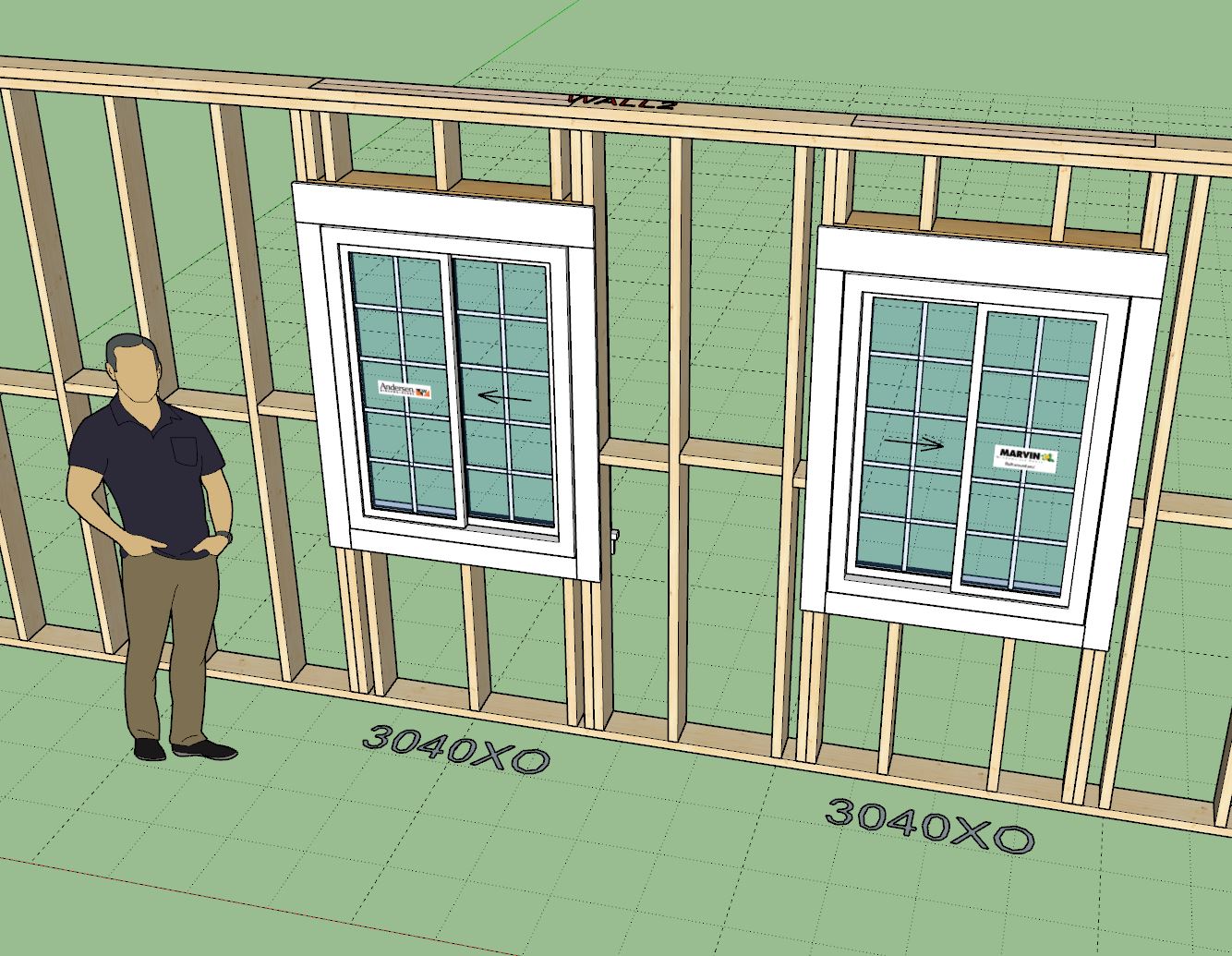

Medeek
Version 3.9.6 - 04.19.2025
- Added a "Union Door Gypsum" and "Union Window Gypsum" option into the Sheathing tab of the Global Settings.
- Enabled "seamless" gypsum for gypsum wrapped windows and doors.
Note the difference between the two windows below:
Nathaniel P. Wilkerson, P.E.
Medeek
